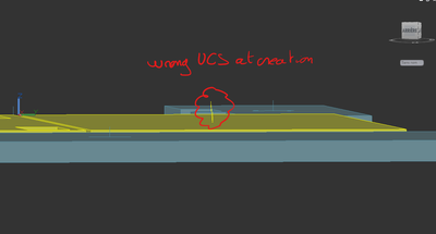

maybe a begining of solution:
the symbol of direction of the grating is wrong see below:
i suppose it was creatig in a wrong ucs and Advance may lost his mind.
Antoine

The yellow grating shown in the picture is part of a small hinged hatch made from steel profiles ( not shown in the model ) and mentioned FRP grating.  Steel profiles / this grating are created in world CS. Once I created them, I rotated the steel frame/ FRP around the hinge in order to check the maximum angle of the opening. Then all objects are returned to the initial state. The grating direction symbol remains as per rotated position.
I don't have access to AS right now but definitely would try to recreate grating later.
Thanks for the tips!

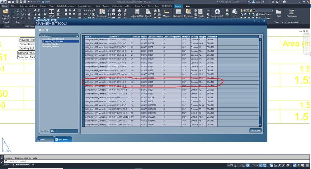

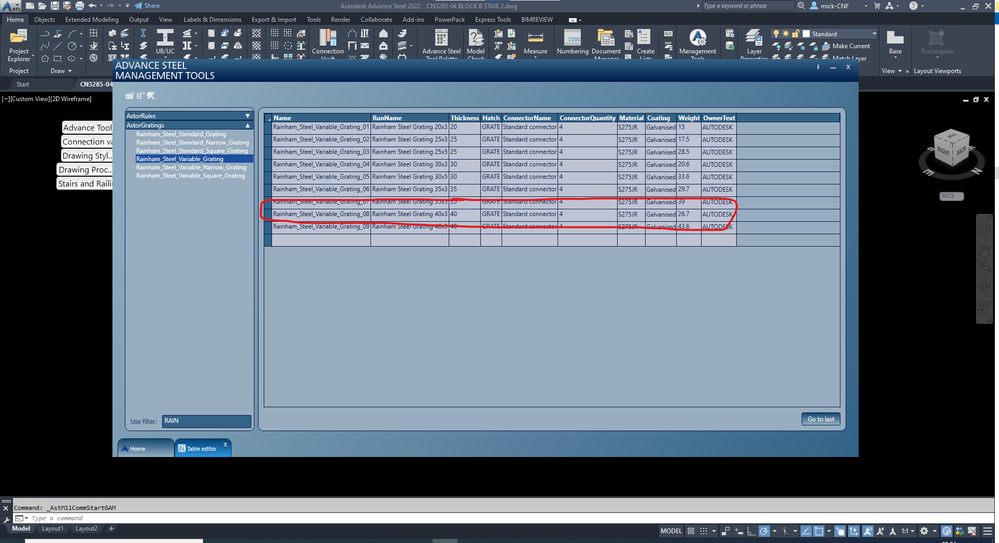

I created two new gratings, one steel and one GRP.
The weights are different because they are set in MT with weights per square metre.

 @AntDrt  - after I recreate grating - There was no problem this time. Thank you for the tip about the grating symbol!

The grating weight is set by the weight in your second image.
I had a look at the Webforge brochure and those three are the only ones I could see.
The material changes the weight on plates and beams.
