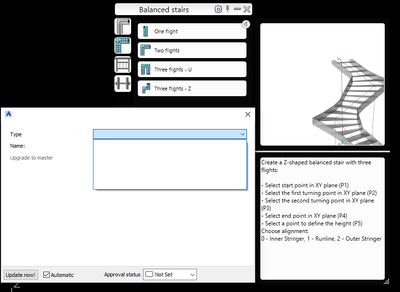

I installed power pack free trial version. I got license from graitec for one month, but type lists are stil empty.

Hi @Kvothe_23
So its looks like something hasnt gone correctly with the install. To correct the issue please follow the steps below.
1. Make sure you have a backup of your Advance Steel data before doing anything else - https://www.graitec.co.uk/blog/entry/are-you-backing-up-your-advance-steel-data
2. Close all Advance Steel / AutoCAD products
3. Open Control panel > Programs > Programs & Features > Your version of Advance Steel
4. Click Change
5. In the dialogue click Repair or Reinstall then Repair
6. Let the system run the repair then the macro shoudl work. If not repeat 2-5 but choose Reinstall
The macro should work as expected then. As point please ensure you have a backup of your data before proceeding.
