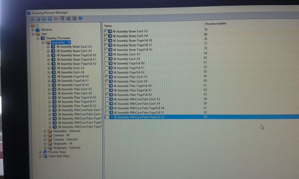

Same version advance steel 2016 international, but i dont have list like on second picture so my prototypes does not work. Please help me how to change this list?

just press on "plus"?

Of course i tried ''+''. Folder names and drowing processes are not the same, look at the picture. Anyone has idea how are this drowing processes files diferent in same version of advance steel 2016?

From the images, I suspect you have English uk installed, if you look under the cold rolled you will see a dummy drawing style to confirm this.
also the assembly, camera and parts look like the UK install.
to get this to the required international version you need to run the reinstall option under add remove programmes , before you do this rename the advance 2016 folder to have a slightly different name, e.g advance2016-org.
Run on the reinstall and select the international opition at the language dialog.  Hopefully it should correct and install the right data set.
good luck
