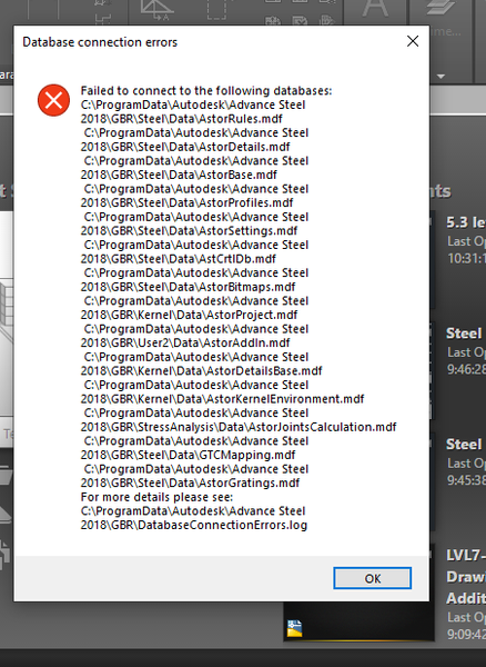

Hi all,
i am re
ceiving the database connection errors, please find the attached snap and advise the solutions

Hi @desigan2015
Couple of questions for you,
1. Has the GBR folder been copied from another machine?
2. Has anything been changed with the GBR folder, was it working a day or so ago?
3. Have there been any windows updates etc recently?
There are a couple of things, the system cvant read the databases so its either a permissions issue or the databases have been copied from another machine and are locked to that machine, see steps below.
Make sure your Advance Steel is shut before doing these steps, I would also advise taking a backup of your data first - https://graitec.co.uk/blog/entry/are-you-backing-up-your-advance-steel-data
1. Go to the following folder - C:\ProgramData\Autodesk\Advance Steel 2018
2. Right click on GBR and go to security
3. Click the edit button
3. For every Group or User (Except CREATOR OWNER) make sure that Full control and Modify are ticked, then click apply
4. Click OK and on the properties diague and go to the general tab, make sure Read only isnt ticked, click apply and ok.
This should set the permissions correctly so Advance Steel has access to the databases. Run Advance Steel and see if this has fixed the issue.
The next step to try is deleting the lock files.
1. Go to C:\ProgramData\Autodesk\Advance Steel 2018\GBR
2. Repeate step 3 for all the following folder
                User2/Data
                StressAnalysis/Data
                Steel/Data
                Management Tools
                Kernal/Data
                DatabaseUpdate
3. In each of the above folders there will be a ".ldf" file, these are the lock files you can delete them. Please do NOT delete the ".mdf" files, these are you Advance Steel databases
Restart your Advance Steel, all should be working

desigan2015
Hi sir , recently i didn't do any updates. i have followed your instructions and restart the computer but still same error . after long i can open the model but its very slow. please advise

desigan2015
sir , i already tried to repair but still shows error . just now i have uninstalled , now reinstalling again thanks. I have done the back up . after the installation i would like to bring back all my setting please advise .

desigan2015
@robertwmerriman2  after uninstall and reinstall AS also the same error i am getting . for your information i using AS 2018 . two day ago i have updated my windows ,from yesterday i am getting this problem.

My IT solved this problem . He said due to windows updates . He restore the windows updates then install back AS 2018 . so far no issue .
