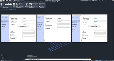

Similarly when I place a bolt I want it to automatically select the bolt role but I have to enable it on each launch of AS2020 here:
It is a very obscure menu that I came across in google images. It should be in the defaults menu to assign the bolt role to any bolt placed in the model.

The dropdown for setting which property should be transmitted to the next created one, is very helpful.
If you want to set these, you could do this in your template.dwt.  So you could open dwt, create the  objects like beam, plate and screws and set these checkboxes. And after you did this for all object, you could delete these object and save the dwt.
For example:
You don't want to transmit the modelrole for screws for all objects? Then open the dwt create a screw uncheck the the modelrole, delete the screw+save the dwt. In the next model you create, this property will not be transmitted.
But if you use joints, the modelrole often is created and blocked by the joints, so you could change it, by deleting the jointbox.
We have a tool for overwriting blocked properties, but this is third party and not standard in AS.
Another way could be (for the next time) to to use a "joint group", so by changing the role in the master joint, the other will be changed automatic.

@Sebastian_Eiche  Thanks for the reply, the main topic was originally another question I had, but I appreciate the input on the 2nd topic I mentioned.
I tried saving the dwt after making a beam, bolt, plate and setting the default model roles using the right click selection at the top of the window and they seem to revert back to default once I close and reopen Advance steel.
Message 6 of 16

Sebastian_Eiche
you're right this is not working. I thought it is 🤔
I also tried to use a dwg as template but after restarting AS, this checkboxes are all uncheck.
I'm doing a few more tests, but I think you will have to do this at every new start.
Maybe there's an automatic way by using the actionrecorder of AutoCAD: "create beam+set the boxes+ delete beam"

matthewobrn
@Sebastian_Eiche
Thanks for the idea. I tried the action recorder and it didn't work.
It opens 3 advance property prompts but the check boxes are not set.
I didnt know it was possible to open more then one advance property window at the same time.
