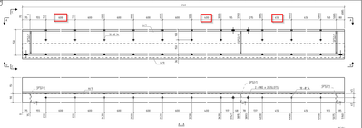

I have completed all drawing but not show special part in some drawing views like top and bottom view. after changing drawing style I created new drawing, showing special part in all view but i want to show in already completed drawings.

sounds like you create a detail of selected elements...so if you use a selection, it could  not be change afterwards. for this the cameras could be used much better.

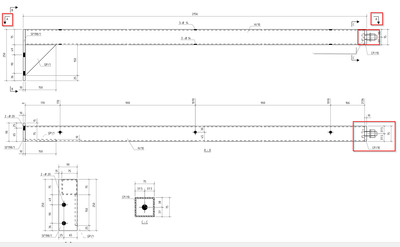

I attached screen short for your understand my problem
and thanks for your replay

the question is: which detail style do you use?Do you create the cut view manual or is it an automatic cut view?
If you recreate the detail all is working? So what is the problem to delete the old one?

I use manual section cut not automatic and its my client requirement showing special part in all view like top section and bottom section like blow

It looks like AS does not want to bring in the special part after the drawing has been created, but I assume that it comes in OK on newly created drawings?
I have had similar issues before.  You have a few options:
1. Add a note to the drawing calling off / noting special part.
2. Draw special part detail in 2D CAD and overlay onto drawing.
3. Re-create the drawing.
AS has many issues like this.  We all just have to try to work around them.

by doing manual cut views, you could use the "setting" option to define the detail style. Maybe you use one which didn't show it. This is important for doing correct cut views.
To change the cut view detail is not possible in every situation, but you could try to open the dwg, open the DSM, select the detail style and then the "use" button and try to overwrite the cut view.

this is not proper solution but i use already this method but this method is time consuming.

why is this not a solution?
You created details and want to add objects. If this would update automatic, just think about you use this detail style in other project (where you don't want see the special parts).
What should Advance Steel do in this case? Update the details as in the other project or not update them because it's another project?
Advance Steel is software which could just do, what the user decided to do. So if the user did something,this will be done by the software.
