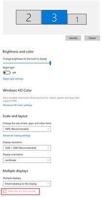

mark_sandersonKUJZA
I am not sure if this will work for others, but it worked for me. If you are using multiple screens. Make the screen that you have Advanced Steel on the Main Display. The tool bar should appear.
