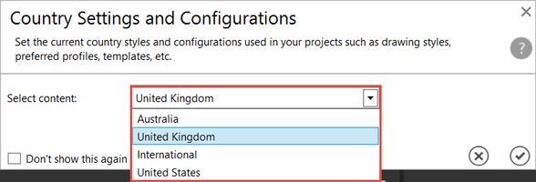

If you have installed Advance Steel 2019 in English on your computer, a solution is to choose the country "Content" when you start the software:
Nota: if this "Country Settings and Configurations" dialog box does not show up when you start Advance Steel, you need to go to the Management Tools > Options, and then un-select this setting and restart Advance Steel:
Here is how it works:
If you choose "Australia" ...
... then you will have access to drawing styles for Australia:
If you choose "United Kingdom" ...
.... then you will have access to drawing styles for the UK:
Hope it helps,
Regards / Philippe
