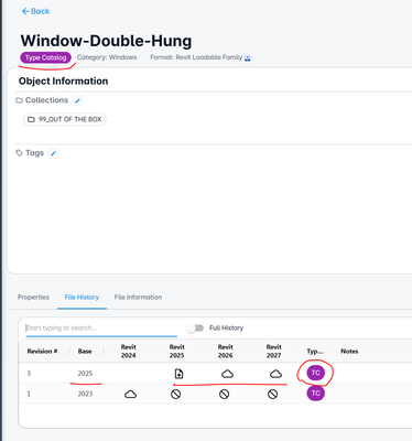

@Ric_Weber i still cannot get most of my Type Catalogs to work with the Content Catalog. I even struggle with the OOTB content. We use Revit 2025 mainly. I have linked the a family that is currently not working with CC but works fine when loading from the folder. I am truly confused why this would not work with CC.
Message 20 of 23
curtisridenour
Well, i figured it out. Some of the Autodesk OOTB type catalogs txt files have the parameter type and unit lower case. This works fine when you load it into Revit locally. But when you use Content Catalog it does not. I changed it to be as follows:
,Width##LENGTH##INCHES,Height##LENGTH##INCHES
18"" x 32"",18,32
18"" x 36"",18,36
18"" x 42"",18,42
18"" x 46"",18,46
It works fine. But when INCHES and LENGTH were lower case. it did not work on content catalog only. i am so miffed. I even downloaded the whole library from Autodesk again and only some of the type catalogs have this issue with the lower case. So that's what i spent half of my day on today. lower case vs upper case.
