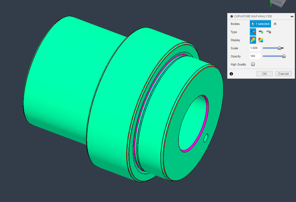

Christoph_360
Hello everyone
Is there a setting so that tangential transition edges are displayed with a thinner line than sharp edges, so that you can better see optically tangential transition edges.
Does anyone have any ideas?

Does the Curvature map help?
Mark Hughes

Message 13 of 13
TrippyLighting
@Christoph_360 Please mark one of the posts as the solution. It has be stated that the functionality you are looking for does not exists. That might not be the answer you were looking for, but is still is the solution as it pertains to Fusion 360.
