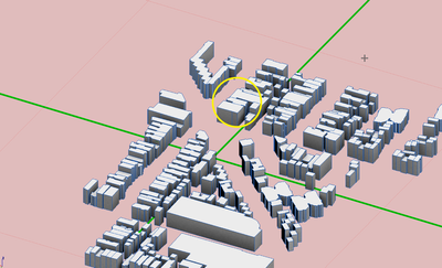

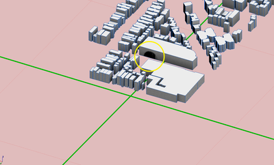

Hi, I'm baking AO into my textures and about 20% of my models are yielding a really strange result: the baked AO is totally mis-aligned.  It's almost like Max is rendering using a different Map Channel or something.  Or the model is reading the UVW map incorrectly.  Sorry, I don't have enough experience with UVW's and Map Channels to be able to clearly articulate what's going on.
They are simple Editable Meshes.  I add an Unwrap UVW, Quick peel and flatten them, then render to texture.  Not sure why some work fine and other don't.
I've tried rendering them in batches and rendering them individually.
I've tried removing UVW's and Material and redoing the process.
I've tried resetting Max and merging the problematic models in.
Any pointers would be much appreciated.

Sorry for the delay in responding.  Got pulled into another project and didn't have time to troubleshoot this.
I tried your technique and it yielded the same results.
I also tried a bunch of combinations below:
Reset XForm and then collapse stack to Editable Mesh > No change
Center axis and align to work > No change
Delete Unwrap UVW modifier and verify I'm doing the exact same steps on each model > No change
Isolate the model > very much improved, almost completely, but there are definitely still some quirks.
It's almost like 3ds Max thinks the model is in a different location that it actually is.  It seems like 3ds Max is rendering shadow from objects that are actually not there.
I'm kind of at a loss what I should try next.  Any help would be appreciate.

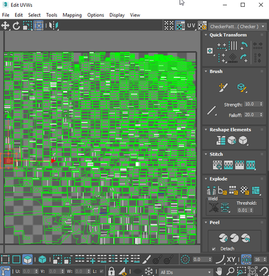

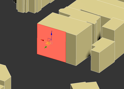

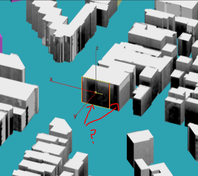

I seems okay.  I guess I'm not 100% sure what I'm supposed to be looking for.  In the image below, I've selected a face that I know is one that is messed up when I render to texture.  I select it and you can see it in the UV Editor.  When I move it around or scale it, it behaves as I would expect.
 Then I render to texture...
Message 8 of 18
miledrizk
I think you have a problem with your geometry itself,
From your screenshots I'm guessing you have overlapping faces,
And this is shown in what it looks like overlapping UVs(2 UVs at the same place)
Overlapping UVsOverlapping UVs
Overlapping PolygonsOverlapping Polygons
I need you to go to the Polygon Sub-Object level on the object shown in the image above,
Click to select the polygon and press delete. I'm guessing you'll find another Polygon in the same place.
If this is the case then you'll have to do some cleaning to your geometry before Rendering to Texture.

Thanks for sticking with me.
So it deleted the faces and there didn't appear to be anything behind.
I also created a new face there and the render to texture had the same result.
Message 10 of 18

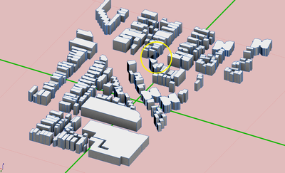

Okay, I think I'm zeroing in on the culprit but I'm not quite there...
As I said in my previous post, if I move the models far away in the scene, they render fine.
Next I tried moving the models just a little bit and saw that the weird shadow stayed in the same location:

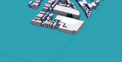

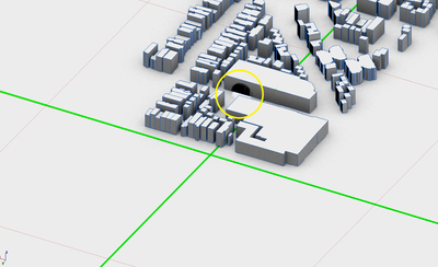

So I reset Max and merged in only the single model.  First thing I notice is when I create a new Standard material, it started at Material #46.  The next one was Material #67.  Usually it goes Material #25, Material #26, etc.  So it appears that there are some embedded/buried materials in the model.  A lot of them.  Anyone know how to confirm that?
Next, I did a few render to textures while moving the model around and, yep, there's some object in there creating shadows when it renders to texture:
I rendered the texture of the plane and:
I only have two objects in my scene: the model of the buildings and the plane.  But just to confirm that the ghost object is actually in the model of the buildings, I rendered one with just the plane:
So there you have it.  It appears that some of my models have ghost geometry that is casting shadows when I render to texture.  This ghost geometry stays in the same world space no matter where the actual geometry is (hence why is cast the shadow in the same spot no matter what geometry is there).  And this ghost geometry sticks around within the model even if you export as obj, or reset XForm, or remove UVWs, or remove materials.
Not sure how it happened.  I was optimizing this scene for a game engine so I was attaching and detaching a lot.  Grouping geometry together.  Converting to Editable Poly and then Editable Mesh.  Stuff like that.  I bet I collapsed a stack somewhere or deleted only an element of an Editable Poly or something like that and the information got embedded in the model.
At least, that what it seems like to my tired brain, lol.  I've been troubleshooting this for about 12 hours now so I'm a bit burned out, lol.  Gonna call it a night.
Any suggestions would be very much appreciated.
Cheers.
