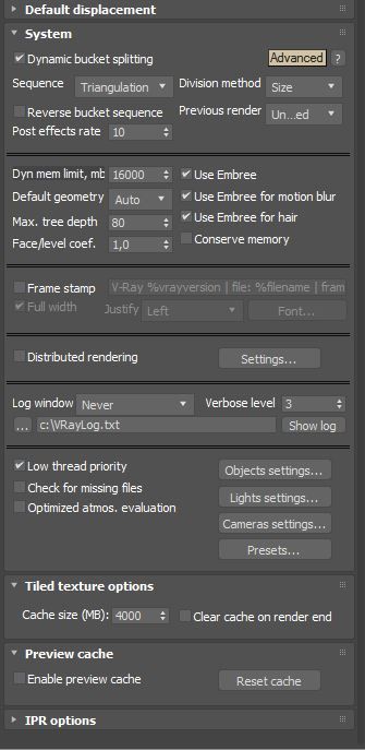

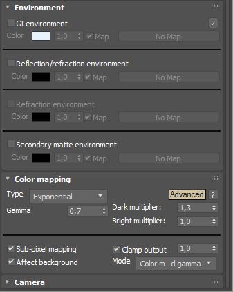

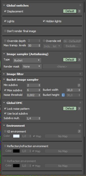

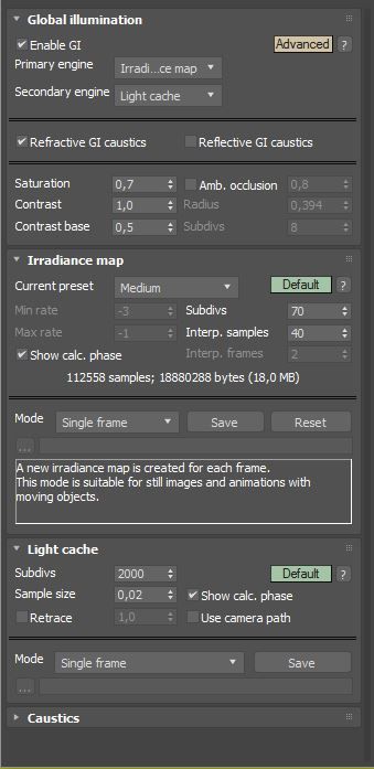

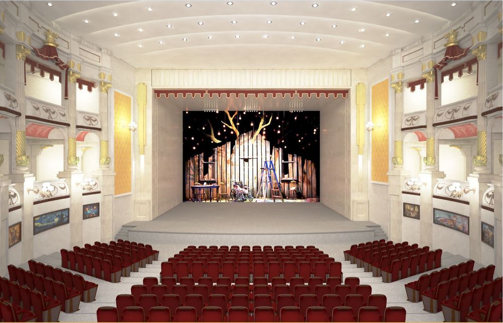

Hi everyone,
I have problem with saved rendered image. When i hit the render button, fine and exact image renders in vray frame buffer, which is ; (i took it with printsceen)render 6.jpg
But after that i hit the save button and result is;
render 10.jpgthe result is less realistic and brighter image. My actual problem is ; How can i keep the first image when i save it.
I thought ' i have problem with gamma but cannot figure the solve it.
My render setup like this;
I hope that, anyone can help me with the keep the first image when i save it.
And I thank you to spend your precious time for reading this.
Best Regards.

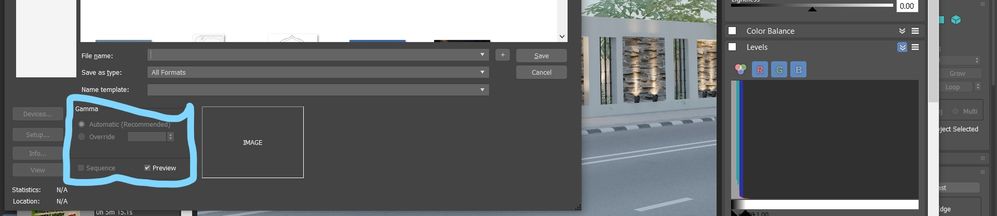

If anyone has the same problem , i have found the solution when i tried by myself. And the solution is very simple; Ekran Alıntısı.JPG
If you choose the ''Override'' option when you saving the rendered image, it will exactly save as in the frame buffer version.

Hi. when i try to solve this problem your way i find this option locked, how can i activate it?2020-05-03_LI.jpg
Message 6 of 8
Hi there. Can you check Gamma / LUT Correction Panel. You can find it Customize-->Preferences--> Gamma and LUT and you can find it there, check the tick button ''Enable Gamma/LUT correction. If it is not ticked , you can't control override option. I hope it will solve your problem. It is the only thing that in my mind to solve your problem. I hope it works.

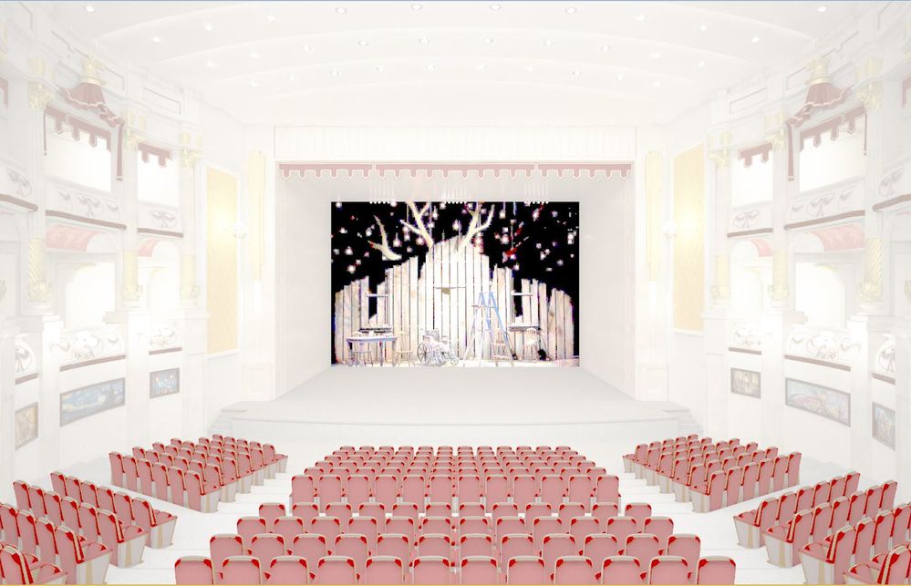

Hi there, Thanks for your sharing that post about the difference between the rendering images problem, I was searching about the solution until I have found you talk about it, I followed up your steps in the solution but I couldn't fix it until now, Beside this problem, I have another weird thing, it is when I save the image as a JPG, it appears different also if I save it as a PNG.
JPG imageJPG imagePNG imagePNG image
@Anonymous
Do you have any idea about that?
Thanks in advance
