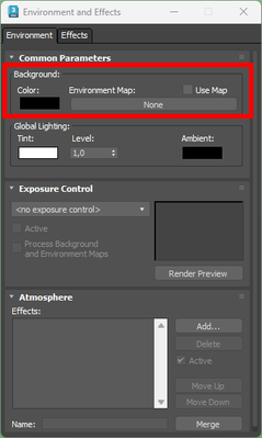

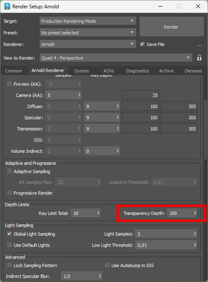

Good day everyone,
I have come across an issue, unsure what the cause is, I have researched and checked all the obvious culprits listed within the forums and Autodesk articles.
  1. The material is a Arnold Standard surface,it  has no maps and is part of a multimaterial.
  2. I am using GPU Arnold 5.9.1.1
  3. 3ds Max 2027
  4. Export format .exr (viewed in Photoshop using EXR-IO).
Below you will find screenshots of the settings. I would greatly appreciate it, if someone has any ideas to share.
Many thanks in advance!
