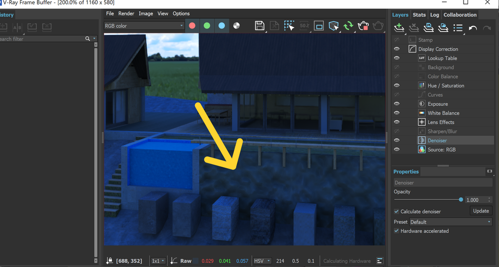

I imported a file from Sketchup. The imported materials show fine in the viewport, but if I use a VRay material, it doesn't show in the same amount of detail as the ones imported from Sketchup. I have tried all the options in the "Show Materials in Viewport as" submenu and none of them have corrected the issue. As seen in the attachment, the "show shaded material in viewport" is selected.
Also, initially I thought the materials added in 3ds Max looked good in the render, but after the render finished, it's showing some really weird texture.
Screenshots of both viewport as render attached for reference.

RobH2
You have a lot going on in the 'Layers' of the Frame Buffer. Delete all of the effects and get back to what I attached. Save the file with a new name, close and reopen Max. Let me know what happens.

dlangpapR6UXD
Thanks, I tried that, still same results both in viewport and render.

RobH2
It's the texture you have on your Dome light. Replace it with the one I attached and it should work. I think I'm ok to share this HDRI as it seems like everyone in the world uses it and has it.... 🙂
Your HDRI is casting a lot of blue light into the scene. You can use it as the background and you can use another one for lighting.

dlangpapR6UXD
Thank you! I tried the HDRI you sent, but I'm not sure I'm being very clear in my questions. The problems are that:
1. The materials from 3ds Max don't look realistic in the viewport. viewport.PNG
So compare the materials that were already in the imported Sketchup file: the house, the roof, the concrete below the pool...with the material applied from 3ds Max: the concrete below the railing and the concrete blocks I put below to compare with the render. As you can see, the 3DS Max materials look blurry. The problem is I don't want to have to render every time I use a new material to see if it looks right as that takes too much time. I should be able to see it pretty clearly already in the viewport.
2. The rendered material doesn't look anything like the same material applied to a block for testing or to the material photo from Materials. The concrete material below the railing is the same as the one of the first block from the right, yet they look very different. I don't think the wavy texture that appears in that area below the railing looks like concrete at all, at least not like the material photo.

CAMedeck
In some of the earlier screenshots, I feel like the UVW mapping on the objects is not correct.  You may need to apply a new UVW Map modifier to any objects that are not displaying the material correctly.  It appears you are using Real World Coordinates for your textures, but Sketchup objects don't use that by default.  Also, check your map sizes, the one you included in a screenshot above is tiling at 1 inch square which is pretty small.
Chris Medeck
Message 18 of 18
Casey_H_
Hi there.
1. The 'wavy' concrete on the block looks like a UV mapping issue.
2. For VRay, try turning "Use full resolution for viewport" on in the map settings near the bottom of the Params rollout.
