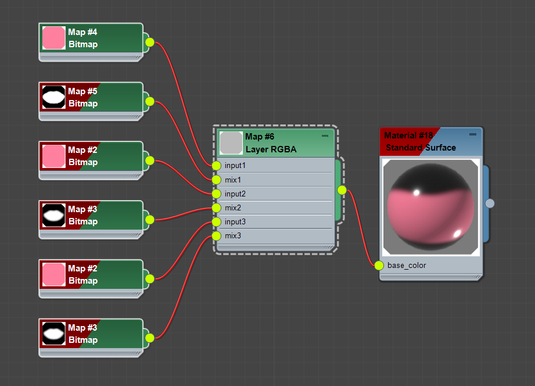

Simply use LayerRGBA:

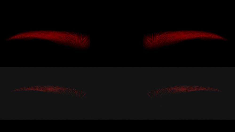

Thats what i tried in the first place, but got different results with standard and Arnold materials. Thought there is an other setup needed to accomplish the task.
Eyebrows example:
Upper eyebrows material is standard, lower is Arnold
Save and textures attached.
