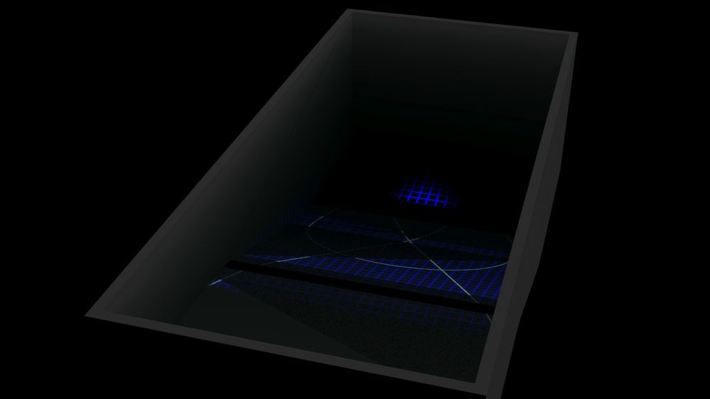

Greetings,
Please refer to MAX attachment and required PNG image file. Attempting to render an image at the bottom of a swimming pool.
Can’t get the expected coverage that works out using geometry. The projected pattern should not be hitting the sides of the pool as it does when the pool is empty (shown here (refer to hidden layer ‘AV-REF-GEOMETRY”)).nowater.jpg
When “AV-POOL-WATER-solid” layer (with refractive material applied) is un-hidden it appears to reduce image brightness but coverage is unaffected.withwater.jpg
Using Max2014, but problem persists in Max2018 also.
Thank you.

I think I understand where this is going now...
You want the water object to actually bend the path of the light being projected from your light source to emulate what would really happen if a light was projecting an image onto the bottom of a pool in the real world.
What you need is Caustics.  Without it, Max will not reflect or refract light.  It can do it to rays when rendering through glass or water, but the actual light is not bent, only the picture we see.  Enabling Caustics will tell Max to affect the path of the light energy.  And take a lot longer to render.  And there's a lot of fiddling with settings to make it look just right.
Google 3ds Max Caustics, and you'll find some tutorials and explanations of how it all works.
Chris Medeck
Message 6 of 18
That's exactly what I want. I need to show the result of refraction (bent light path) and how the coverage is reduced as compared to the absence of water. I will try 'caustics'.

Caustics helps. I can see the effect of the refraction. Problem is the image gets 'absorbed' by the 'water-solid' so there is no image on the bottom of the pool. I'm sure my settings are wrong but have no idea which ones to adjust.withwater03.jpg
Message 10 of 18
Using "Caustics" makes a difference. But, the image quality I get upon rendering, though generally correct, is lacking in quality no doubt dependent on other settings I have no idea about.

I think there are a few things factoring in to the darkness of your scene. When the light hits your water surface, its trying to bounce the lights off six different sides, instead of just one. I would recreate your water object to be a single plane, covering only the top of the swimming pool.
I would also suggest changing your light type to an area light, as your current top down directional light may be casting some harsh, confusing shadows onto the mesh below as well.

I used your recommendation of a plane just for the water's surface. First image is 'empty' pool showing over-projection on the sides of the pool. Second image is with water-plane and caustics rendered showing how refraction affects the coverage (reduced) at the bottom of the pool. This is what I would have expected.

I got the same results. I suggest that you also change your lighting to a omni light, as the harsh directional light isn't helping the shadows bouncing off the glass materials.
I took some time and did some tests with the scene you provided to illustrate why I suggest using the Autodesk Water Material over a glass material, this, among a few others, is the reason why you are getting such a dark render. I have also attached the scene with the changes I made to the scene, I hope you don't mind!Render_without bottom.png
As you can see, I added a noise modifier onto a dense, single plane mesh to get the watery effect, I got the technique from the video I linked above. I took off the image you linked to your light, as it was creating visual noise, I added it back in as a texture map to the bottom of the pool in this next render.Render_with bottom.png
I would suggest fully unwrapping your swimming pool and adding a full tile texture, but that depends on how realistic and detailed you want this shot to be.

The object of this exercise is to visualize the real-world effect of refraction (caused by the water in an indoor pool) on an image projected from above through the water to the pool bottom surface. A projector light is used so that I can emulate a specific physical projected image size (based on available lenses). When this setup is installed and in use the pool surface will be near to a perfect flat plane (no ripples due to pool operations/filters etc.) and the water should be almost perfectly clear. Room lighting would also be minimal.

I would suggest selecting the bottom of the pool deck mesh and detaching it.
I would then go into the  light settings and click on the exclude button. That will bring up a list of all the objects within the scene. You can exclude the outside parts of the pool, that way the projection will only project onto the bottom of the scene! Here is where the exclude button is, and what the pop up looks like.Screenshot (88).png
