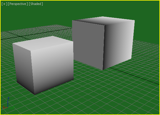

Just apply your material to the box, apply a UVWMap (set to Planar). You WILL have to alter the rotation of the UVWMap Gizmo to align the Gradient in the proper direction, and if your Box is not a Cube you may also have to Scale the Gizmo to make it match the object (once you've rotated it). In the case of your model it should be only just as high and as wide as the model itself.
Note. 2 boxes, 1 material (same on both boxes). Only the UVWMap Gizmos have been changed.

PROH
Hi. In the UVW map modifier, set the alignment axis to Y instead of Z. On both your pictures it's on Z.

Message 8 of 8
aah now it catches ... thanks a lot !
