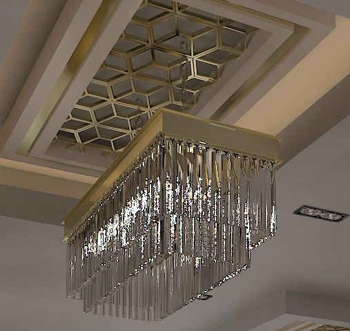

deneme.jpg   Im having a light noise problem at my chandelier. This is my render can you help me about how can i fix this noise problem. I have increased reflect, refract and light subdivs it didnt helped. Also i increased the GI subdivs too please help me.

No, that's not a subdiv problem.
First, check in the frame buffer if Force color clamping is activated.
Do you have clamp enabled in your settings??
did you check the box subpixel??
Also since there is so much glass over the glass you should increase the depth of your refractions and maybe reflections, those are under advanced in render settings.
Check all that and let us know if that works.

I tried all you said I couldn't find box subpixel and clamp enabled inside the render settings
