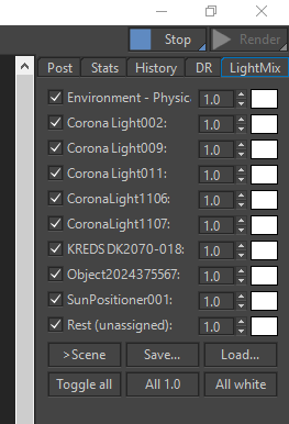

Message 4 of 18
darawork
This is the Lightmix section I was referencing:
The final tab in the Virtual Frame Buffer.
All my values are set to 1.0 or less.
You can set up a lightmix by choosing the button in the Render Settings -> Scene Tab;
What I do is set up the Lightmix, then while Realtime Rendering I change the lightmix spinner values to what I want, this might be 50.0 or more sometimes. Once I like how the scene lighting is looking I then press the [>Scene] button (as seen in the 1st image above). This bakes the values into the lights in the scene, and returns the Lightmix multipliers to 1.0.
If I wasn't to press the [>scene] button, and leave one or more lightmix spinner values above 1.0, then what happens is the VFB Lightmix spinner multiplies the light (and the noise from that light) rather than the actual light multiplying itself inside the scene (from 1.0 intensity to 50.0 or whatever). The render engine then has to work 50 times as hard to get rid of the noise down to your chosen percentage. A lot of people fall for this, and it ends up taking hours to render a scene, when it should be minutes.
The same thing happens if anything is too unnaturally bright in the scene (which can be checked with the Albedo Element pass). Something unnaturally white (255) will reflect rays nearly like it is emitting them, and they will bounce all around the scene slowing stuff down. Same with using a light emitting material to illuminate the scene, this should not happen. Always use designated lightsources. You might have seen these tips in the video.
Regards,
Darawork

CADLAB22
Same here...
