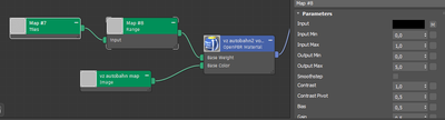

Message 7 of 8
wernienst
You could wire shaders to the Base Weight channel that create values above 1.0
Here I used a Tiles map and a Range shader. (Sign texture from Wikipedia)
