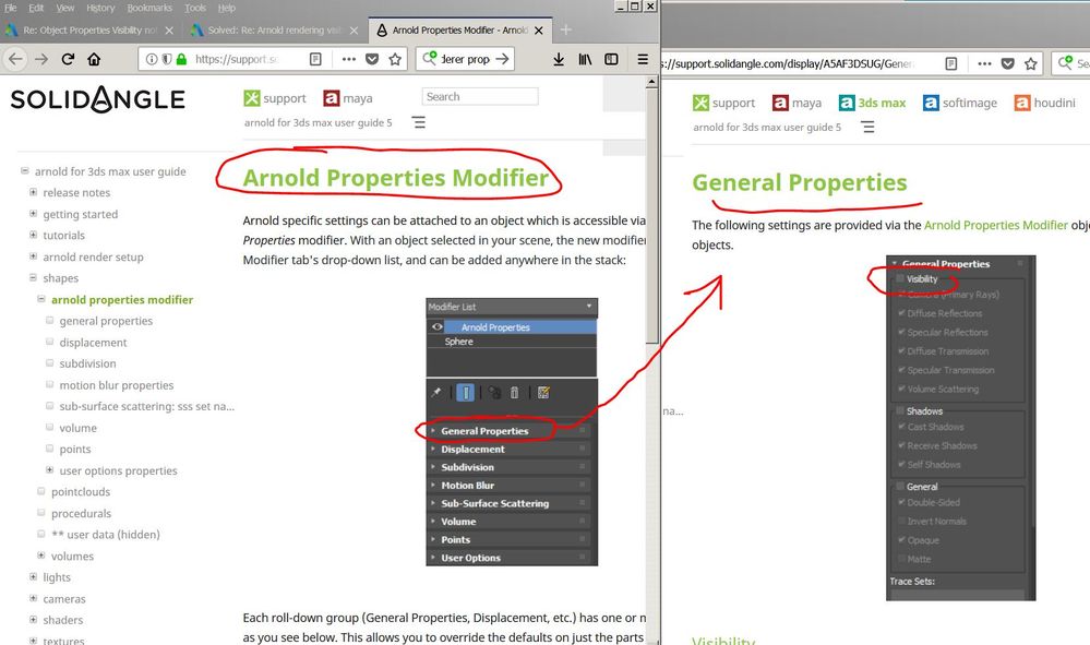

Looked it up but no instructions for where / how to open it in Arnold Properties Modifier.JPG3ds MAx....   Arnold documentation for max is really, really poor.  Please help.

I found the Arnold Properties Modifier!  It is an actual MODIFIER available in the modifier panel drop down list that you can add to any selected object in the scene BUT unlike the parameters of ANY OTHER MODIFIER that I can think of, the parameters of the Arnold modifier CAN NOT BE KEY FRAMED.   They do turn on/off visibility but without being able to key frame them... having the modifier is only helpful for static adjustment of the many Arnold parameters so of no value for animators who want to use key frames to turn things on/off.
