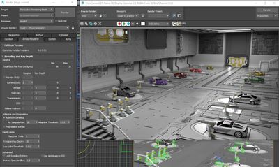

Is there a tutorial for 3ds max 2021 denoising? I do not mean the OptiX denoiser but the actual Arnold Denoiser with the AOVs. The AOV manager is totally different in the 2021 version and I am lost completely. I would really appreciate some video tutorials.

My apologies but the Arnold Denoiser tab calls it "Arnold Denoiser".
What is a CPU denoiser? Do you mean that the Arnold Denoiser only works with the CPU render mode not the GPU? That would explain that even though I added the appropriate AOVs it is still not perform the denoise process. Can you clarify this? Because if
I am wasting my time with the GPU renderer for my production render. I thought I could seriously reduce render times for 1080p video renders but if that is an illusion then i need to move on to more serious rendering engines and reconsider my scenes. I also tried everything you recommended in your earlier video on noise reduction but I cannot get a cleaner image (see screenshot). I do not know what I am doing wrong.

Arnold comes with OptiX, which is the GPU denoiser. it works if you have a newer cuda enabled and preferably RTX model.
There is also a CPU denoiser, the one you show in your image, but dont use that if you have a gpu you want to denoise with.
The best thing you can do if you have a GPU and can render with it is to Add an AOV called RGBA its the very top one.
Then tick the "denoise" flag in the AOV line, restart rendering and it will apear in the AOV list so you can swap to it live.
You do not do this in Production mode, you do it in Active shade mode while Arnold just stands and renders the whole time, while you work.

Yes I have an RTX 2080 Ti. i would like to take full advantage of it. The .EXR denoised images were created even with the production renderer, so I guess I could just use those denoised images as my final render result? Are these denoised AOVs flicker less than the OptiX denoised ones or they are pretty much the same in quality.
I also performed what you recommended and added each AOV to the activeshade and fired up the active shade to see the different passes. here they are with current settings (camera AA:2, diffuse:1, specular:1):
 BY far specular and indirect are the noisies are the noisiest passes. I keep AA at level 3 and you are right does not change the  quality much increasing it. Is this supposed to improve when i increase the specular and diffuse ray depth? By the way not sure if you saw but you cannot change the ray samples for specular and diffuse when in the GPU mode! When I turn the specular and diffuse to 0 I get a very fast render even with CPU. But then I will lose material reflections right? Ok, I think I am getting closer but still I am not sure how to get this resolve.
