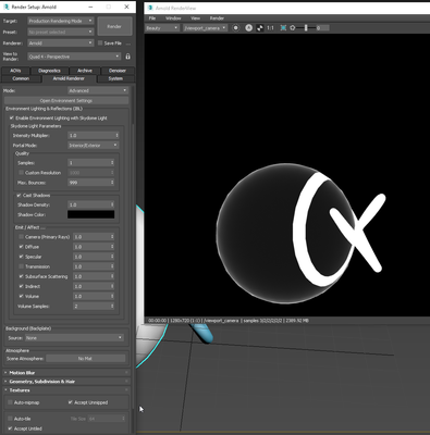

Stephen.Blair
With a default new scene, I set it up like this (the sphere is glass)
or

Red171
Hey Stephen,
You are a legend.
Simply setting the background(backplate) in the Arnold Renderer panel to none sorted it. I am still using the OSL HDRI environment map in the environment slot on the environment and effects panel as the only thing lighting the scene. Working no problem. Amazing how annoyingly simple but obscure that fix was lol. Really appreciate your time,
