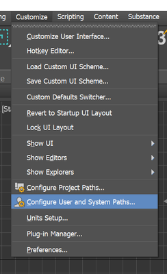

if you can't/don't want to do that you can ask Max to look somewhere else by going to customise > configure User and System paths:
If you have created a toolbar button to call a script then Max will save a version of that script as a macro.
C:\Users\NAME\AppData\Local\Autodesk\3dsMax\2022 - 64bit\ENU\usermacros
So if you want buttons to work make sure that what ever folder Max is saving these macros to, is not in a hierarchy of folders that is hidden.
In my case I had to unhide the Appdata folder as well as my user folder in order for everything to work.
