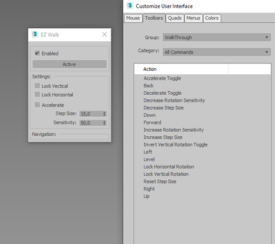

Hi!
I built a UI and gathered the necessary code, but I need help to put it together.
Macroscript that activates walkThrough + it needs to open the UI:

 the UI:
rollout WalkThrough_Rollout "WalkThrough" width:600 height:267

Message 2 of 19
denisT.MaxDoctor
Here is a snippet that shows how I would do something like your task...
try (destroydialog ::EZ_WALK_STRUCT.dialog) catch()

You need to add navigation functionality, storing/restoring dialog recent placement and dock state, and maybe something else
Message 3 of 19
Haider_of_Sweden
Thank you very much @denisT.MaxDoctor
This is a very beautiful solution.

I was interested in this task, although I don’t see much point in such a substitution ... but nevertheless.
I'm assuming you want by pressing (releasing) a button to simulate typing DOWN/UP arrow keys (up, down, left, right)?
Built-in rollout button controls cannot work this way. They capture focus. They must be released to release the focus. Here's how they're made. Maybe ImgTags can be used instead. Or it's probably possible to use .Net or Qt buttons. But they also need to be set to something other than the default.
You're right Denis - the navigation itself is of little use. I made that mockup to have something to work on.
The commands were taken from the macroscripts below.
What is of bigger use is the possibility to dock and store its dock location upon the next Max launch.
This should be something rather common, no? Do you have the time to make your EZ Walk dockable?

Thank you very much for this addition. 😻
(Sorry for not replying immediately, I am not ungrateful, just so much else that calls for my attention)
Your previous tool, EZ Walk is compatible with cameras.
Do you know why this latter one, the Viewport Navigation, is only supported by the viewport and not cameras?
