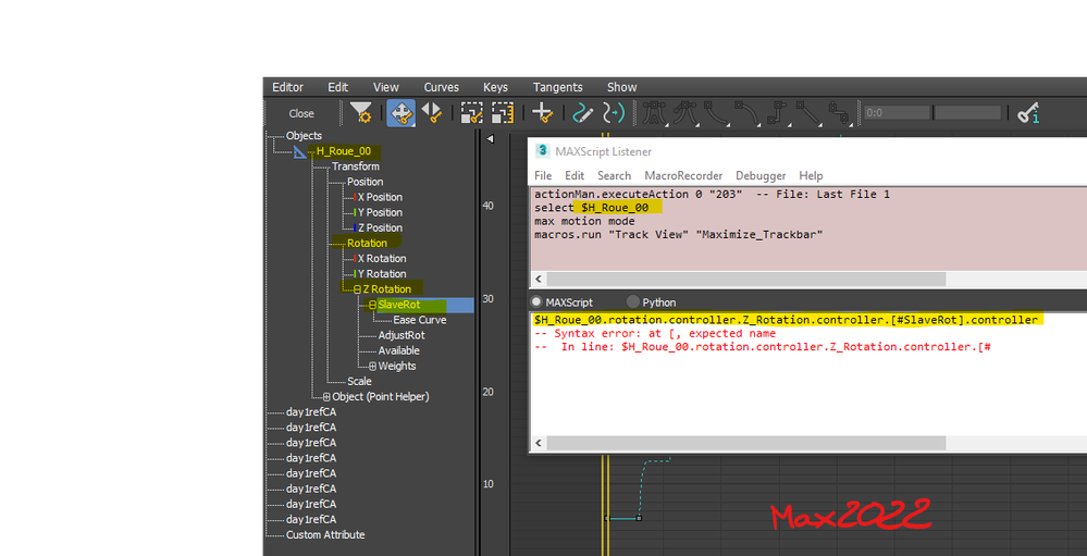

richardGRWZS
You think the logic of the syntax is good but it's just a problem with my actual scene test ?
Here is a screenshot of my test with the manual request in the listener:
Message 6 of 10
denisT.MaxDoctor
You're working with expression controllers the wrong way....
(I'm not talking about syntax errors now, but the concept as a whole)
look at my example, use MXS help to understand, ask questions if something is not clear:
