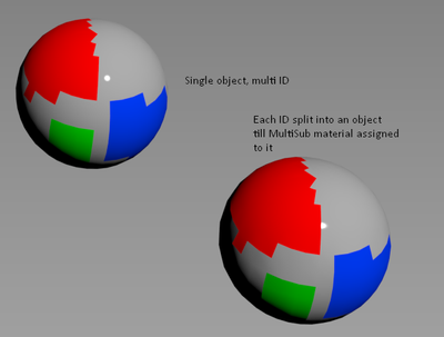

Could someone please help me with a Maxscript, that assigns only that one material from a multi-sub material that is used on a mesh, based on its ID?
Background:
I got a mesh with multiple IDs
Naturally, you need a multi/sub material for each ID
I have a script that detaches the mesh based on their ID
So far, each mesh still has a multi/sub material assigned. I might want to reorder the IDs, or attach and do a new Match Material IDs to Material. There might be other cases you need this to be cleaned up.

Haider_of_Sweden
A bit late, but thanks, @denisT.MaxDoctor !
I wanted to add a Material modifier, and set it to 1.
addModifier $ (Materialmodifier materialid:1)
I think there might be a better way.
The purpose is that once this object has one single material, I would want to reset the IDs as well.
How can it be done?

Haider_of_Sweden
I was going to use it together with your first assignSingleSubMaterial anyway, so I tried with mapped and selection and it works.
How did you intend it to be used?
Also. a strange behavior (for me at least, illiterate in MXS as I am) I encountered during my tests, is when I wrote setNodeMaterialID objects
I selected only the split objects, not the single objects with multi-sub-materials.
Then I ran both assignSingleSubMaterial objects and setNodeMaterialID objects (note objects), this happened
does Objects mean ALL objects in the scene?
