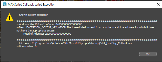

If I choose Biped and play the animation with motion panel open, there will be a delay(Frame drop).
So, I made a simple MaxScript to unselect object and play the animation before playing the animation.
There's no problem in general situations.
But if I open the Workbench window and play the animation,
3dsMax closes with an error.
I looked for a command to close the WorkBench window before playing the animation, but I couldn't find it.
Is there a another command to close the WorkBench window?
Or I was wondering if there is a command that can bypass the error.

	for hwnd in uiaccessor.GetPopupDialogs() where matchpattern (uiaccessor.GetWindowText hwnd) pattern:"*Workbench" do
		uiaccessor.CloseDialog hwnd
But it's better to find what state of the Workbench is causing the crash. By default it's stable and doesn't crash.
