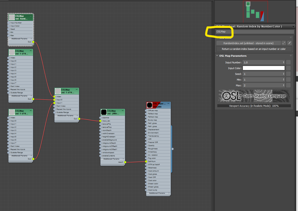

that worked well. can you show how to imbed the OSL code into the maxscript(using .OSLCode)?
also when running the script the name always shows as "OSLMap". can that be changed?Screenshot 2021-07-06 163642.png
