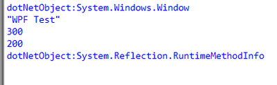

Message 18 of 38
denisT.MaxDoctor
how is about ShowDialog() instead?
there is another way to try:
w = dotnetObject "System.Windows.Window"
w.Title = "WPF Test"
w.Width = 300
w.Height = 200
m = (w.GetType()).GetMethod "Show"
m.Invoke w #()
In theory, all should work the same... but it's definitely a MAX's bug, and there might stay some ways that aren't broken.
Message 19 of 38
MartinBeh
Again, the UI freezes up, fast-exit to desktop.
Here is the Listener output:
Martin B   EESignature
→ please 'Like' posts that are helpful; if a post answers your question please click the "Accept Solution" button.
