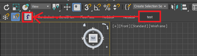

Hi.
1) Is it possible in the window I created through the max script to go to the standard standard panel 3ds max?
2) Is it possible to make a script in which my button will be created, but when I click on it, another standard button will be pressed?
Example I click on the test button and when it is pressed, another button is pressed and executed.

if you can't find the command, you can try handles through UIAccessor.something like this:
mainChildren =UIAccessor.GetChildWindows (windows.getMaxHWND())
nowTime = sliderTime
checkMount = #()
for i in mainChildren do(
if (UIAccessor.GetWindowText i)==(nowTime.frame as integer) as string then ( append checkMount i)
animator
