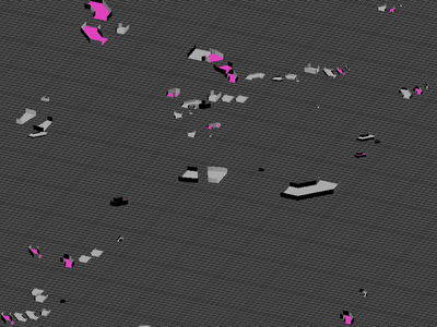

Hi
I have a geometry has a lot individual elements
Is there a script or way  I can select only the Top facing or bottom face?
Many thanks
Henry
291 Views
denisT.MaxDoctor
There is a built-in Select by Normal in the Graphite selection tools
denisT.MaxDoctor
If you are looking for a MAX Script solution: Select Faces based on normal?
This is quite old but still makes sense and works
PS. I'm sure you can find many examples on this subject. This is one of the most popular tasks for learning MAX Script.
