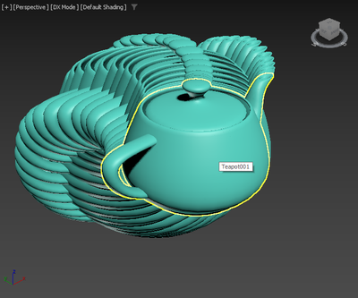

I compile this plugin and load it in Max 2023. Here's what I get, when switching a wireframe- and default-shaded viewport to use the custom background:
The overlay for object selection / hit-testing works, as do tooltips, gizmos and wireframes. But the background is always black and the object is not shaded.
I also tried switching the viewport to DX Mode and found that the background is not drawn at all:
... So I tried changing the Nitrous driver to DX9, restarted Max and that seems to work (after loading the plugin manually due to D3D errors at startup relegated the plugin to deferred loading):
However, this is not a solution. I want the DX11 shader to work, but I'm not sure what's causing it to break. I've confirmed the shader compiles, all the handles are valid, and the call to SetBackgroundFragment() succeeds.
Perhaps the howto example is out of date? Some guidance would sure be helpful here!

Thanks for the reply. These changes do not fix the issue, unfortunately. It seems that something changed though. I still get a black background, but if I rapidly click between two viewports (i.e. repeatedly changing active viewport), I sometimes see a brief flash of the yellow/green gradient that this shader outputs. So it does appear to be rendering, but something else is stomping over it.

I can confirm the issue is fixed as of 3ds Max 2023.2 but not in any other major releases at the time of writing.
This is a particular problem in Max 2022, because that's the version when other established viewport drawing techniques stopped working forever. It's the main reason I investigated HLSL as an alternative, before discovering it basically never worked.
Can the fix please be applied to Max 2022, as well as earlier versions that you still maintain?
