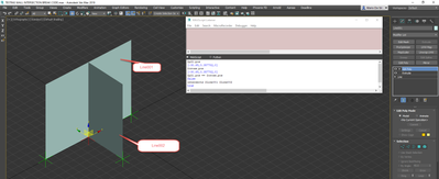

kenc
@denisT.MaxDoctor I am back to work and I am trying your code from above
I drew 2 lines in top view, where the second was drawn from the midpoint of the first. I then extruded both and converted to edit poly
You can see in the listener that both p21 and cross have the same position but do not equate the same. But the intersect command says they do intersect.
Message 33 of 37
denisT.MaxDoctor
