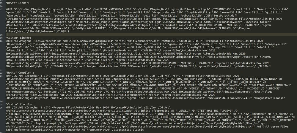

As far as I can tell, the paths to the libraries and includes are correct, the name and order of the loaded libraries are also the same. But for some reason, in a custom project, the "IObjectDisplay2" class is considered abstract. At the same time, the "howto" examples compile and run without any problems. Perhaps there are some additional VS settings responsible for importing libraries that I don't know about. I will be glad to any advice.

This is the base Wizard template created via Procedural Objects->SimpleObject2, the only thing I did for the example was to add an extra inheritance from MaxSDK::Graphics::IObjectDisplay2 class.
At the same time, this action in the project from "howto" does not cause any problems.
Here are the linker and compiler options, from "howto" and from my custom project:
Message 7 of 8
steff3d2JA5W
Many attempts to upload compiler properties as text to the forum failed, so I'm attaching a screenshot. And a link to the text: https://sharetext.me/ki3ir2iz0g
The bottom line is that the external paths and lib names and order are the same, but the libraries in the user project for some reason does not work..

I finally got it! For some reason, I thought that libraries are responsible for the implementation of all IObjectDisplay2 methods.
But the PrepareDisplay and UpdatePerNodeItems methods are completely virtual and I myself have to declare and implement them in my class.  Sorry for misleading, question closed.
