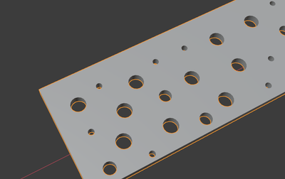

Hi everyone,
I made a model with holes in the blender, with a mesh like below
after that I exported model to .fbx and import to 3Ds Max with this settings:
After import model to 3ds Max, these holes looks bad
I know that it is the fault of an incorrectly made mesh, but the blender is still able to display the model correctly with such a mesh, and 3ds max has a problem with that.
Is it possible for the model to be displayed as in the blender without any changes in the model grid?

Blender is more than forgiving when it comes to edge-flow... or in other words: everywhere outside of Blender this mesh will be displayed like in Max.
Solution: apply a ProOptimizer-modifier and let it triangulate that mess.
