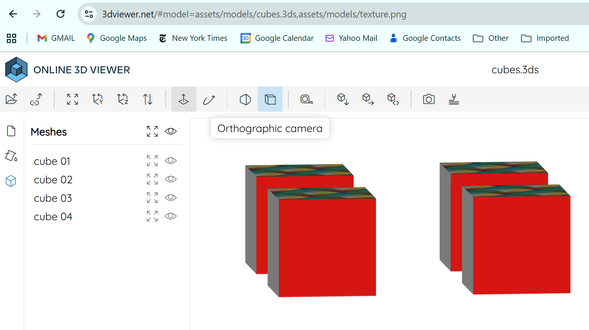

Try the Orthographic camera option for 3dviewer.
