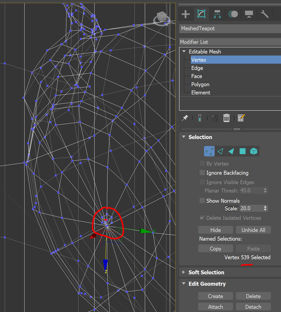

It's interesting to note that each vertex of an editable meshed object has a transform associated with it although the vertex is just a point and conceptually does not have an orientation.   I could not determine the Maxscript syntax to use to get the transform of the numbered vertex of an editable mesh.    As a kludge I tried the following.
I converted a small box (0.1 pre side) to an editable mesh.   I then noted where vertices 1, 2, 3, and 5 were. A vector from 1 to 2 to defines the x axis, 1 to 3 the Y axis and 1 to 5 the z axis.
To experiment with your task I meshed a teapot object and then attached it to the meshed box I previously created.  The result is a meshed object that I know I can use the first three vertices to build the transformation matrix.  I also noted the total number of vertices in the object. In my case it was 538.
Compound Scatter was then used to create a model with multiple instance of the special meshed teapot.  The resulting object was then meshed.  The position of the various instances can be determined by looking at vertices 1, 539 (1 + 538), 1077 (1 + 2 x 538), 1296, etc.
The position of the vertices can be found with
v_pos = (in coordys world getvert obj n)
 where n is the number of the vertex.
To build the matrix for the first row of the transform matric just define a unit* vector for vertex 2 - vertex 2, row 2 is 3 -1, row 3 is 5 - 1, and row 4 is vertex 1.
The process is repeated for the other instance by adding multiples of the total vertex count (538 in my example) to the four vertices 1, 2, 3, and 5.
A script could be written that asks the user for the number of vertices per instance and the number of instances.  From this information it could output a series of transformation matrices.

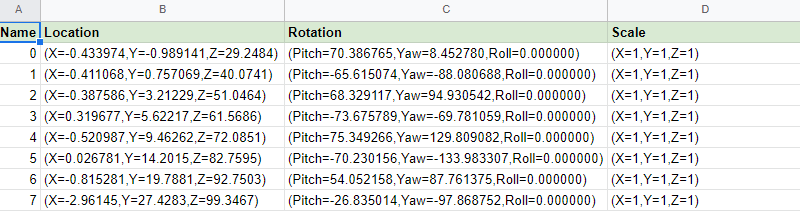

Hi @leeminardi! Just getting back to this thread as I managed to take your script and use it for the purposes that I wanted - export the data out of 3ds Max to be able to replicate the scatter behaviour with other instances. This is the spreadsheet that I managed to create using your script:
The location value is something that your script already provided me with, and the only thing that I needed to do was to calculate the Rotation value (as you see, that field is in a different format to the one that the script outputs) from the transform matrix. I only used the first row thrown by your script, as I found that the X vector was enough to calculate the orientation of the object (or the amount by which I need to rotate something in order for that something to be facing in the same direction as the original scattered instance).
All in all, I just wanted to say thanks for your help once again.
