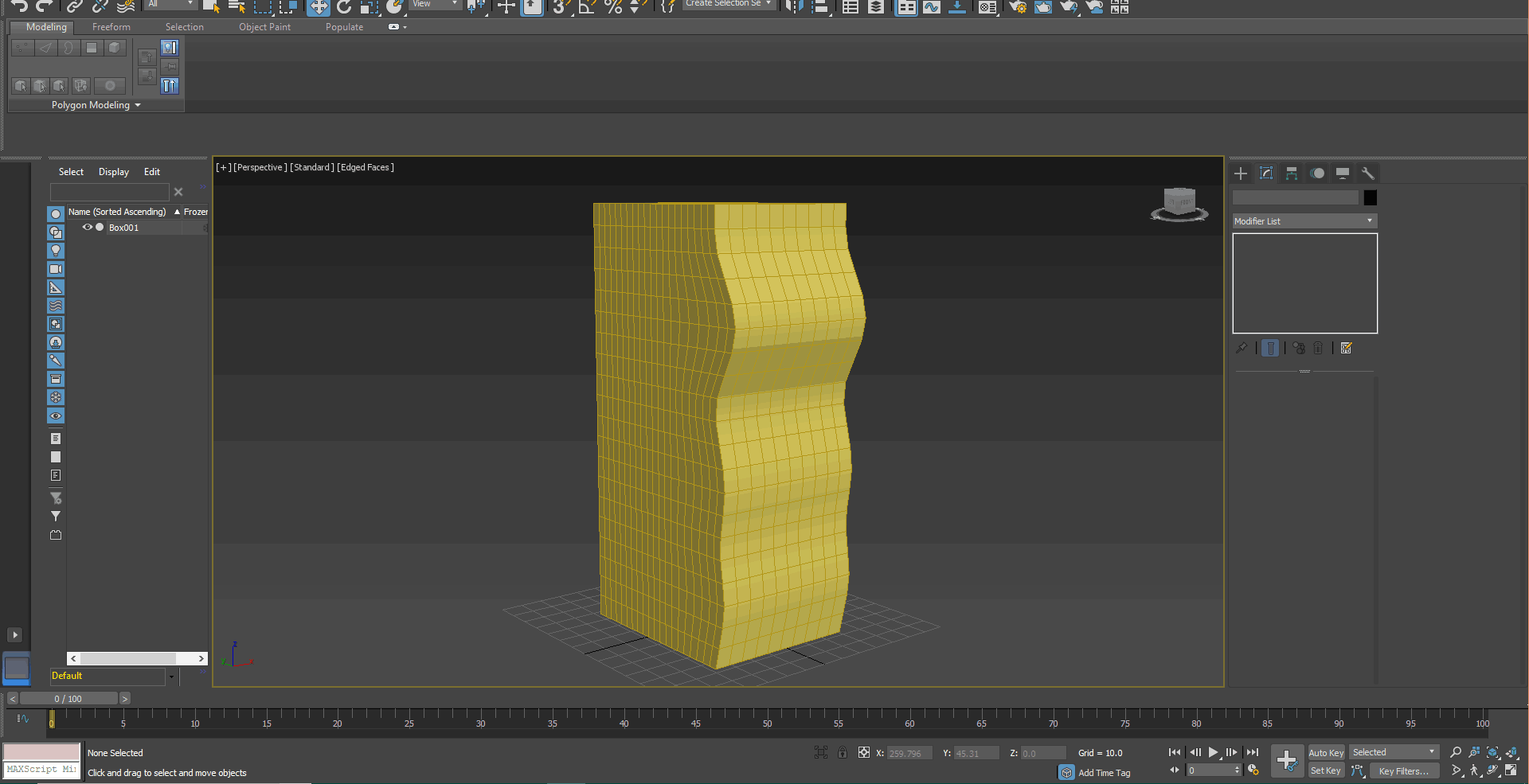

Hi guys,
I am new to 3DS Max/Modeling and I have a problem creating an object with curvatures going along 2 different axis (for example one curvature moving along x-axis, one along y-axis).
Normally its not a big problem. Create your first curvature (doesnt matter what method) and then the other.
Here is the problem:
Please look on the attached example image.
On the right the object with the first curvature created.
On the left an example of curvature I want to add to the selected side of the other object.
As you can see the first created curvature (on the right) needs many vertices and also the curvature on the left that I want to add should be very special and consume a lot of vertices.
Moving all the vertices one by one is very time consuming.
What would be your solution?
Things I have thought of:
  • Boolean (also very time consuming), so not an option
  • FFD (doesnt work well with so many vertices - isnt very exact)
  • As mentioned moving vertex by vertex (not an option)
  • Splines maybe to match the x-postions of the surface for each vertex (in a fast way)???
  • Some way to snap many vertices to a surface quickly??? (with axis constraints)
Please also note that the oject on the right might have some other stuff attached, so some methods might not work/be difficult.
I am thankful for any help.
Wish you a successful start into the week!
Marcus

Hi friend..
Here is an example to easily create curvature you are looking for.
Thank you
Thanks for the tip mate and your time helping me! Here a screencast of my solution combined with yours.
I suppose there are many ways to do this. If you have created surface already with any method you can conform the side of the object to this target.
This is an alternative system to yours that doesn’t need to detach:
Conform brush only one side to a target
You could use the conform brush. But conform brush will ignore selections. For that you need to hide the faces that you don’t want to conform.
Now you need to indicate to Max what object you want to conform to (line001 is the top object)
Now set a high strength (200) and a relatively large brush
Also set freeze constrains in the axis you don’t want to move. Otherwise the projection can be wobbly as the vertex can move laterally (not always)
Now use the conform brush until all faces fit your target
Unhide

One of the best is a cheap script from Miauu package 2: drop on project on surface
its quite instant and doesnt need setup
it allows soft selections
