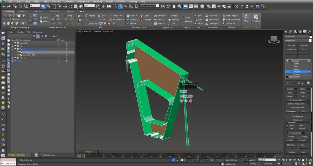

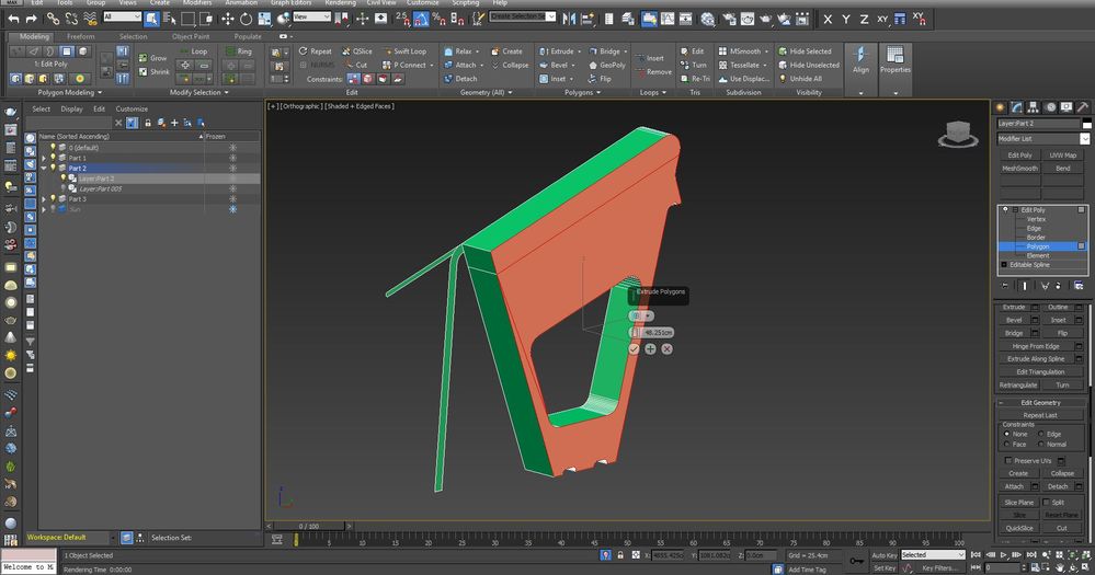

 Problem with extruding I used to be get face from each side now when i extrude any object even a simple box I can only get the front face not the back face. i tried all help suggestions from other posts like vertices on difference planes and starting with a 3d perimitive but still have the same problem.. what am I missing ? please help. thanks in advance. EDIT: SORRY FOR DOUBLE POSTING DUE TO CONNECTION PROBLEM.

but there is 1 more thing, your solution was for line based extrusions but what about extruding from polygons??
It creates no Start Capping it only caps the direction of the extrusion and leaves the back end Hollow, also there is no option for capping when in polygon mode, is there a way to go around that ? also applying multiple extrusions doesn't solve it, thanks a lot once again !
