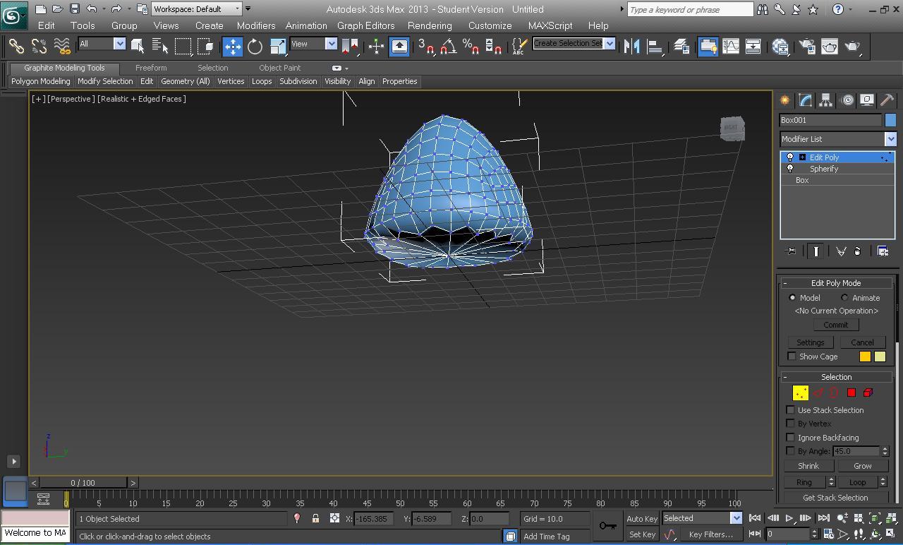

Hi, I'm new to 3ds max and I'm trying to follow the viking helmet modeling tutorial. However, when I reach the step of mesh smooth, what I get is different from the tutorial. The bottom of the object is not flat. Can someone please tell me what is wrong? Thanks.
Before appling msmooth:
After applying msmooth:

That looks like a solid object - a helmet isn't solid, so remove the poly(s) on the bottom.
Please try and post sensible sized images - those are way too small to be of much use as no real detail can be seen. Also, a link to the tutorial (if it is not a "paid for" one) would be useful - we have no idea how you got to that position so can only guess at what is wrong.

I followed each step in the tutorial but couldn't get a flat bottom after applying msmooth.
I used 3ds Max 2013 student edition.
I try to upload the pictures again.
This is what it looks like before applying msmooth:
And this is after:
And in the tutorial, it looks like:
Steve_Curley
"Refine the Shape" Step 3. You failed to remove the lower section of the sphere.

Thank you very much. Now I get the same shape as in the tutorial.Smiley Happy
