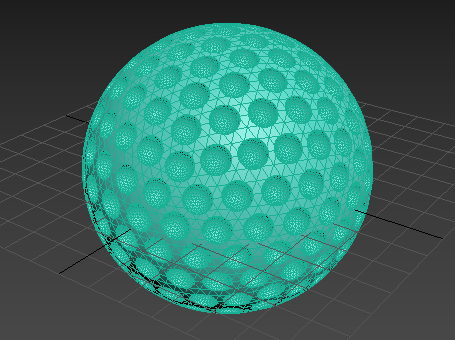

My end goal looks something like this:
My attempt's steps:
  1. Create big Geosphere
  2. Create small Geosphere
  3. Convert big Geosphere to Editable Poly, then select all polygons, detach as element
    1. Intention is so that it becomes a hollow 2D surface, so that boolean later does not just create dimples
  4. Scatter the small Geosphere onto the big Geosphere, at all vertices
  5. Boolean subtract all the small Geospheres from the big Geosphere
    1. Stuck here - the whole thing (all spheres) just disappear
  6. If step 5 was completed properly, I would Shell to add some thickness, yielding the final results.
Could anyone give some pointers on step 5? And/or if this intended workflow is on the right track at all?
I have attached my WIP .max file as well.
Note: As opposed to the common tutorials for hollow spheres (e.g. this video), I need very circular holes. Following that guide (and variants of it), my holes end up triangular, lop-sided, etc, to a degree seemingly unfixable by TurboSmooth.

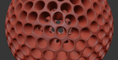

In Object Properties, notice the Faces count. Now add a Retopology Modifier, set Face Count at least twice the count you've just noticed. Keep all other options at their default. Hit Compute. Now you get an object (almost) perfect for your demand.
Here I've added a Shell, then a Turbosmooth Modifier, Iterations: 2

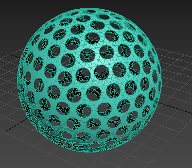

Thanks! I am following workflow, I couldn't get retopology to work like it does for you. I've tried face count x2 and x3, the result remains irregular, like this:
This couldn't be fully fixed by TurboSmooth/OpenSubDiv, the holes remain quite irregular:
3ds max also froze for hours (rest of the computer seemed fine) while doing the Boolean... I've attached my .max attempt again, could you please have a look and see where I've gone wrong?

I'd say your Big GeoSphere has too few segments. As I said, use one for distributing the little spheres and another one with more segments for the Boolean operation.

Thank you! I was afraid to increase the segments more than I did, fearing the freeze in later steps, but it looks like that was really the issue.
