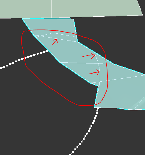

I have a plane and a surface in different levels, and I want to make a whole in the plane on the projection of the surface. Which is the procedure?

I tried but with the shape I have in my scene it does not work. I draw a circle and with the circle is working. I ve attached a screen shot so may be you can help me. I applied some modifiers to the plane and to the shape, you can check in the screen shot. I also want to delete in my plane the area occupied by the other surface, that also appear in the drawing. And finally if I dont want to remove the area of the plan, but convert in another entity, can It be done with this order?

I did and it works, but my problem is why it doesn't work the workaround I have in the upload pic. I have a plane+turbosmooth+displacement and a shape to make the turbo shape, but the max never let me to select the shape. I can select the plane but not the shape. I I try with a circle I can do the hole, but not with my shape.

I just delete the modifiers, both in the planes and the surface. I use the shapes like copy so I can apply them a modifier without changing my plane. But my doubt now is that although I could make the shapemerge I couldnt make the hole. I could make the imprint of the projection but not hollow out the plane.I use the option cookie cutter, but never works, only make the projection. I can erase every poligono in the plane but it takes a lot of time.
Another issue is that now I cant come back to the view with color, I only have the wireframe view.

As far as I understand unlike than in Autocad, in 3ds max you shouldnt use Boolenas much. Thus I prefer to use the shape merge method, but it still not work. I checked you tube videos about shapemerge but I never come across with my problem, or if I try to choose the surface like shape operator in the shapemerge window, simply I cant pick it. Then if in stead of selecting the surface I select the editspiline then I can imprint the shape in the plane but not get a hollow. Please c

) Thank you for your help. I am trying to make a hole with the polyline ( oval shape) in the mesh. I am using shapemerge but there is no way I can do anything.

1- Convert to two roads mesh to Editable Poly so you get rid of all the modifiers mess
2-Select the mesh showing in the image below, go to Polygon sub-object level, select all the
3-Get out from sub-object level, click ShapeMerge while the object is selected, then pick the shape
4-In the image below you can see that the shape is imprinted on the mesh
5-Now add an editable poly on top of the ShapeMerge (you can also convert it to Editable Poly)
6-Go to Polygon sub-object level, the imprinted portion should be selected. Now you can use
Detach to make it a separate object or delete it

Thank you so much. I understand that my error was no flip normals.
