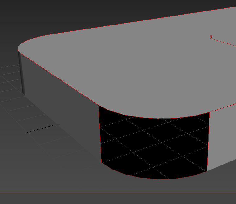

Hi.
https://prnt.sc/pv13mp
Here's the screenshot of the problem.
How to create face in that missing area?
Cap hole does not work. Neither as a single modifier nor when selecting borders.
This should be easy?
As you can see I wanted to chamber edge in order to have rounded corner. That just didn't work for me, so I chambered vertices. And that somehow worked.
I know that this are basics of the 3Ds max, and have googled for many solutions, but it just does not work.

Here is another pic of what I did.
That is supposed to be part of a shelf.
I deleted all the faces along the line where I have missing faces.
I ve tried using border-cap, but it creates some weird faces all around. I want it to create faces just where is missing.
This is a very common problem on the internet for begineers and I've tried my best.
https://www.youtube.com/watch?v=pSH85Lc3OUI
This does not work. Dunno why, but it does not work. I've tried both the edges and borders from edit poly -- cap holes modifier. It creates manu faces. But it does not create the filling in.
https://prnt.sc/pv2o0x
(this is the picture)
But, It just won't work. You see that I just need to "close" the object with a face. But, how to create a face?
I've read some tutorials about step builduing, but 3Ds Max should be much easier to achieve this - not to bother with step builduing. I've read something about connecting vertices, but I should select all of them one by one when doing "create" and that is very time consuming, must there be an easier way to do that.
When it comes to chamfer, I do not know why I can't chamfer an edge or border. I've seen tutorials where people do it normally, but somehow here it is a problem.

@Anonymousfrom your screenshot, this model has open edges all over the place. This means that the polygons aren`t properly welded together. To perform a successful chamfer operations, you will need to fix this piece first.
I highly suggest to model such a piece on your own, which is very simple.And even more so, you can make it parametric, so you can adjust the edge radius and height anytime:

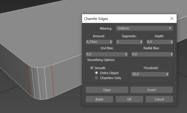

However,if you still plan to fix this imported piece, i suggest starting from scratch with the unaltered geometry:
  1. Go to editablePoly subobject->vertex
  2. Select ALL vertices of the entire piece
  3. Perform a weld operation with a low weld-threshold. Check vertices before/after in the dialog.
  5. If this fixes the geometry, you can continue by chamfering the edges
Let me know how it goes!

Message 7 of 8
The problem with the imported geometry in this case is simply that the mesh has open edges/unwelded vertices. This means that the mesh isn't continuous, the elements are separated from each other. Two or more edges/vertices are sharing the same position, but aren`t welded together
I have prepared a screencast, that demonstrates the problem and how you can try to fix such errors:
