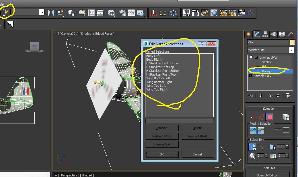

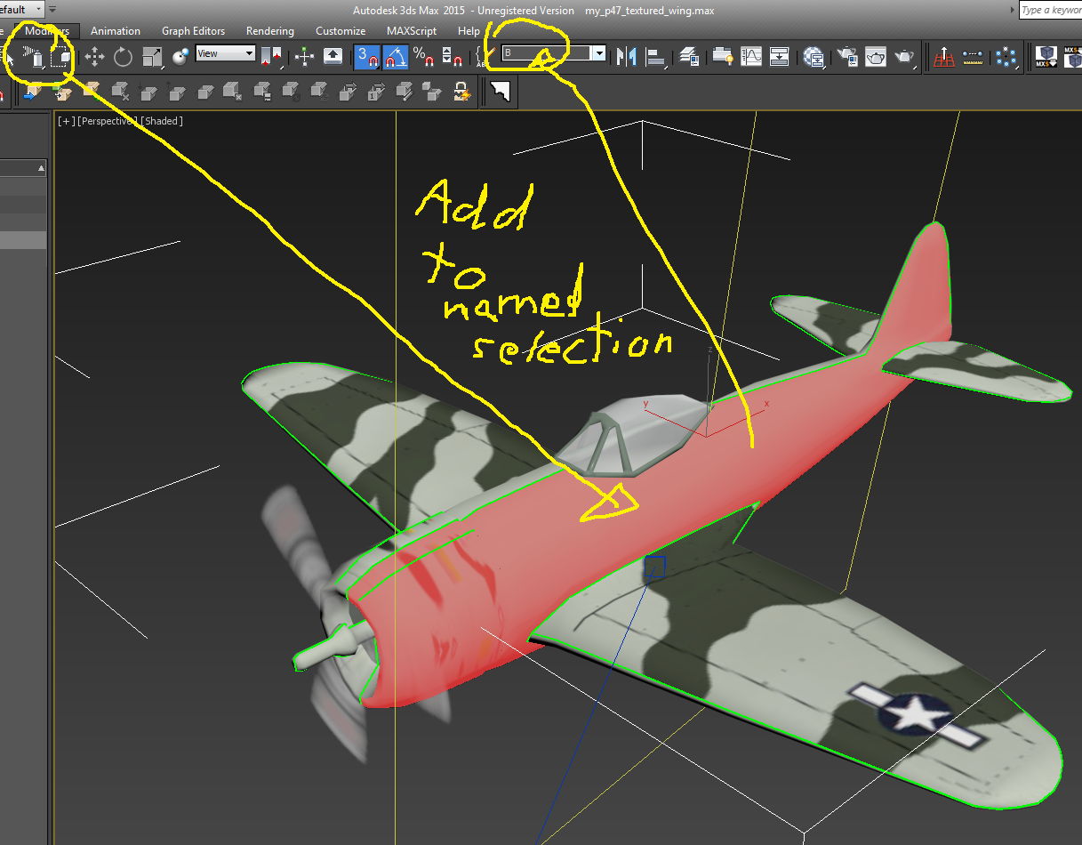

is there an easier way to add to / subtract from named selections than combining separate named selections ?

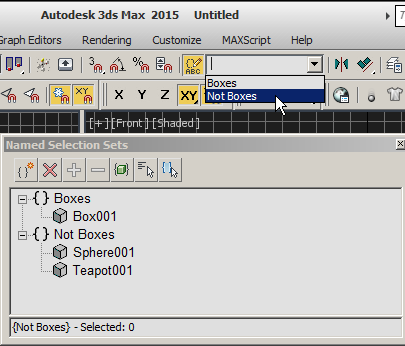

Open the Edit Named Selection Sets dialog (button just to the left of the Selection Sets field in the main Toolbar). You can Right-click a Set > Add Selected Objects, you can drag/drop objects or entire selection sets from one to another, remove objects from a set, add or remove sets...

ok thx. Just wanted to try out, but can't find back, what to pre-select to see the Named Selections in the Drop-Down-List again ?

😮 That's not what I'm seeing. Must be because I changed my Theme. Try closing the Dialog.

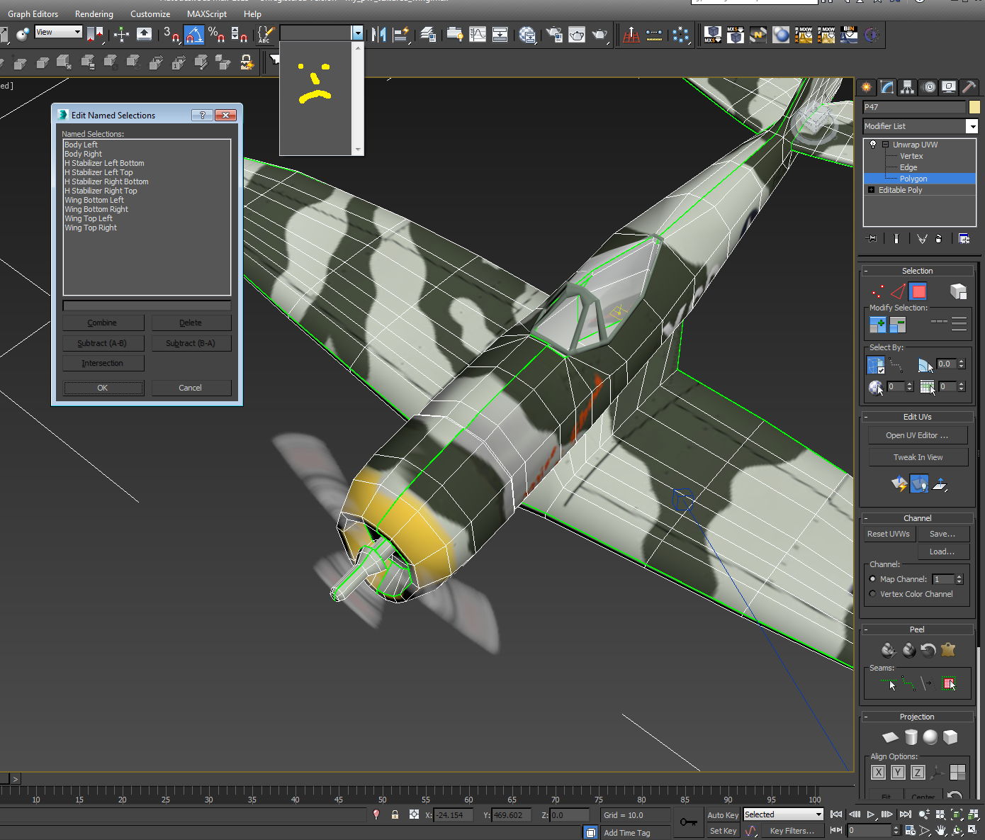

yup i closed the dialog, restarted 3ds, restarted computer ... still Named Selections not coming back to Drop-Down yet :((

ya, the still show up in the Named Selection Editor

Ok, so brain back into gear. I was looking at Object selection sets, you're looking at Sub-Object selection sets. The dialogs are very different. There doesn't appear to be a simple "add to selection" so it looks like the only way to do it is the way you're already doing it, or to select the existing set, add whatever you need then save as a new selection set (all without opening the dialog) then delete the old, unwanted set from the dialog.
That dialog needs some TLC I think.

ok thx 🙂 Already when i want to type a name for a new Named Selection, it won't let me type, it just opens the empty drop-down. This is from another scene, not associated with the other one where i started to recognize the problem.

Lets try a full reset.
Close Max, open an Explorer and navigate to
Users\[user name]\AppData\Local\Autodesk\3ds Max\[Max Version]. In there you'll see an ENU folder. Rename it (OldENU will do).
Start Max and it will recreate that folder with everything set to defaults. Open your scene and try the Selection Sets - if they now work then that was your problem, if not then it has to be a bug, but we need a step-by-step in order to verify it going wrong on other systems.

ok now ! renaming the ENU folder did it. Thank you a lot Steve.
