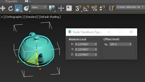

After setting the spinner preference to 7 decimal places (as noted in an earlier post) here's what you would see if you scaled a teapot by 0.1234567 (% implied.  This is a ratio of 1 : 0.001234567 or about one-thousandths as big.
