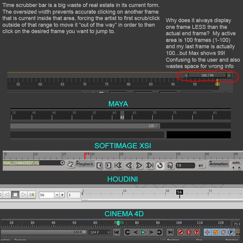

The design of Max’s time slider is a big waste of real estate in its current form. The over-sized width prevents accurate clicking on another frame that is current inside that area, forcing the artist to first scrub/click outside of that range to move it “out of the way” in order to then click on the desired frame you want to jump to.
Why does it always display one frame LESS than the actual end frame? If y active area is 100 frames (1-100) and my last frame is actually 100.. Max shows the final frame count as 99. This is not only confusing to the user but also takes up valuable UI space for info that is at first glance incorrect.
Check out the attached image for a comparison of Max’s time bar to some other popular 3d apps. This will give you a good feel for how dated and clunky it really is.
I've also included a couple of quick concepts for an updated time scrubber that don't involve a complete redesign of how it and the Track Bar work (thus less dev impact). One keeps Max’s traditional prev/next key arrows and colorized to match the trackbar indicator. The other does away with the arrows since there are hotkeys AND additional buttons in the UI for this. It also uses a black background for current frame indicator which I think looks nicer. The width of the icon could change width depending on how many digits are needed to display current frame.

I agree, the time slider is too big, and at the very least it should be slimmed down. It would be great if we could get rid of the Time Slider altogether, and reclaim the vertical space, but that would mess with existing workflows for editing keyframes in the timeline.
As for the frame numbers, it's a long-standing problem. For some reason, 3ds Max has a concept of sequence "length" which is different from "frame count". It's always baffled me that someone actually thought that the last frame of a sequence has no duration. And this crazy misconception has not been corrected in over 20 years of software development. The Time Configuration dialog shows the insanity. The "Length" is always one frame shorter than the "Frame Count".
And to make things worse, the documentation doesn't explain this at all, and in fact gives false, misleading information. The help page for the Time Configuration flat out states that "Length" is "the number of frames in the active time segment", but that is totally wrong. "Length" is actually the duration of time, in frames, between the first and last frames of the sequence, not including the duration of the last frame. It's the End Time frame minus the Start Time frame, but this doesn't account for the duration of the End Time frame itself. It's crazy.
Also, the fact that I have to go into the Time Configuration dialog to change the active time segment slows me down. In Maya, I can change the animation start and end time, and the active time range (which are two different things), directly from the main UI.
Anyway, do we even need to see the "Length" of the active time segment on the Time Slider? Even if this displayed the correct information, how useful is that? In my opinion, it's not necessary, and could be removed to make the Time Slider more narrow horizontally.

Have you guys tried 2018? You can tear off and dock it somewhere else and even it turn off completely if you want. You can also scale it down really small when you do tear it off. The slider itself could probably be smaller.
Also, regarding changing frames of the slider itself, you can use keyboard + mouse commands to change the in/out and 'pan' the slider. I used them all the time when working on sequences 1,000s of frames long.
Change out point: Alt+Ctrl+Right Mouse button drag
Change in point: Alt+Ctrl+Left Mouse drag
Pan frames: Alt+Ctrl+Middle Mouse drag
Keep in mind, if we were going to make additional changes, it would be in the vein of the current implementation. (See attached video in AKN article.)
