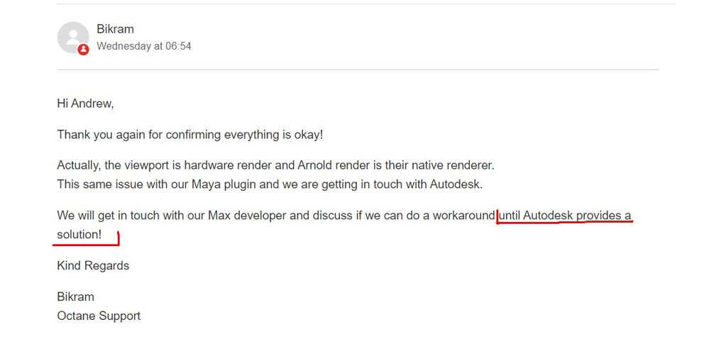

So I already spoke with Ephere(Ornatrix) and OTOY(Octane) teams and they said, that I should write a message to you 😃 Because this is 3ds max issue. I think they've already written to you about it, too. But since they asked me to make such a topic, here I am fulfilling that condition.
So, really proof that they were writing about a issue on the 3ds Max side.
Also they said, in this topic, that this is an Ornatrix issue - https://render.otoy.com/forum/viewtopic.php?f=27&t=80910
But Ephere said, that I should speak with you.
And if you really believe Bikram's letter from Otoy, I really should do it 😃

The Otoy developer suggested that I can use Octane Shadow Matte, Octane Portal Mtl and Standard Material, and it really does. It helps, but to make Octane Hair Mtl work in viewport, like Arnold Renderer Material, we need your help and some solution they are waiting for. If you look at Bikram's letter
So let's solve this issue here, if possible. I hope for your help and solution followed by a patch for 3ds Max.
