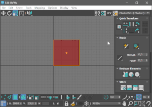

An often overseen feature of the UVW Unwrap Editor is the ability to scale from a specific point using the Set Pivot options, example:
However, there are only five options to choose from - center and the four corners. It would be highly useful to be able to set the center of each side as well, such as center top, center right, etc.

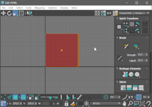

• When undoing it seems the Pivot does not update it's position correctly, making the Pivot drift away each time you undo:
