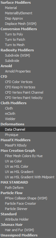

yiannisk: Especially if you turn on categories in the Modifier List (Show All Sets in List), the grouping is pretty non-intuitive (Subdivide being inside Radiosity Modifiers group, Data Channel inside Deformations together with Physique - and Skin in a different group etc, see the pic or check Modifier List yourself).
